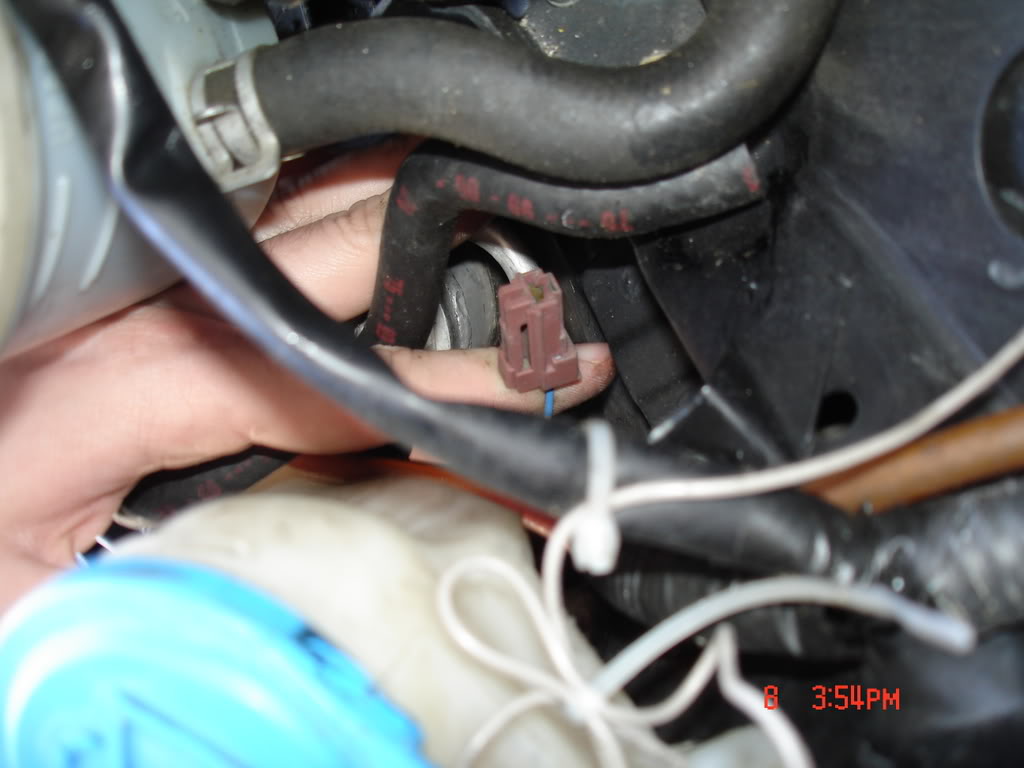

first wire... easiest to find... upfront under the hood drivers side... if you have cruise control box its easier to pull the mounting bolts off the box and move it outta the way. to undo the blue tape holding the conector inplace...
its that brown conector with the BLUE wire... with your fog lights POWER wire simply plug that into that harness then go inside the car...

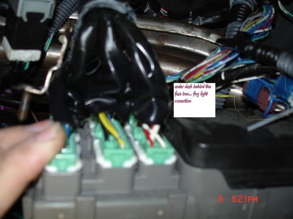

now heres HARDEST WIRE TO FIND!!!!!!
its under the dash remove the 2 fuse box mounting nuts just so you can pull the fuse box to you a few inches to see beter up behind the dash...
it is RIGHT behind the fuse box, near the drivers side of the fuse box.. its right behind that black backplate. and its taped up with BLUE tape and is again a BROWN conector with a BLUE wire... if you dont see the blue wire.. its the wrong conector plug! and trust me thiers at least 3 brown plugs under the dash that i saw!
