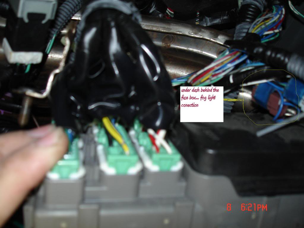

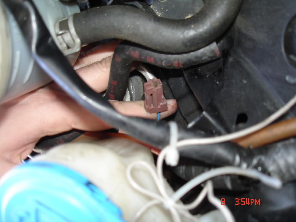

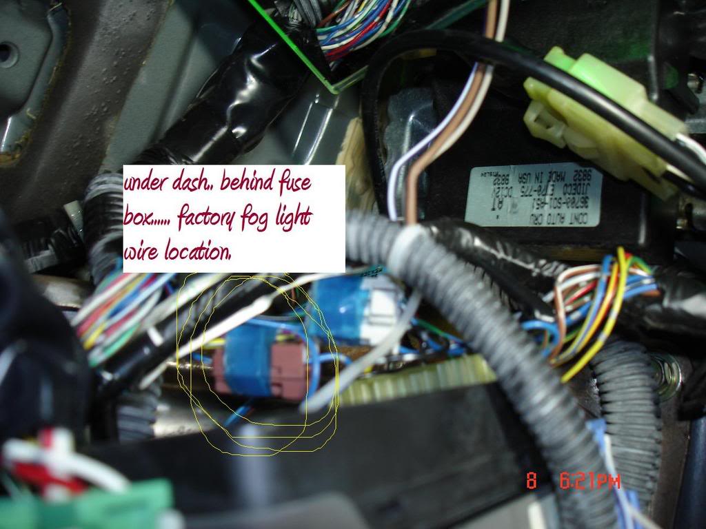

ok a few pics for ya.. those wires are HARD TO FIND!
that wire on mine i had to take loose the cruise control box to get to that wire..
thats the wire under the dash to conect to....
then the next is under the dash....
THAT SHOULD DO YA.... at least for OEM fog light instalation....

Thanks for the fast responce but yeah i found those wires.......but for the under the hood one its the same plug on both ends so maybe i got the wrong kit?

did it come with any instructions? if so post up some pictures.... but if not id say youll have to cut some wires and wire it yourself...
BUT IF I HAD TO GUESS....... id say white wire on the fuse box on a hot all the time port... and the red on the fuse box just ON with the ignition port....
and that black wire for the ground...
now that white plug type... id asume goes to the switch...
BUT AGAIN... thats just my guess!!!!!!!
use a light tester to probe the fuse box ports and be sure!
but again... im not sure... my OEM SI fog lights was almost all plug and play.. which is what i love abotu OEM
the way my OEM pluged in fron the front was that one plug and a ground wire on the rad suport, then under the dash tape into that wire again, then unpluging the wire harness from the headlight switch under the steering colum and wires came out of it that went to a relay box which was powered and everything from the factory wires, and then ran to the oem switch and a ground wire under the dash.

Ok i guess ill cut the front one under the hood since its only one wire anyway. But where is the plug for the factory lights under thee steering wheel? i think thats the part i cant find. Can you circle it in your picture around which area its in?

i done told ya what to do or try....
but you got any pics of ALL the wires that came with your aftermarket fog lights?
white wire to fuse box- power all the time...
red wire to fuse box- when the ignition is ON only...
ground wire... where ever on steel...
and that other 1wire conector to that brown conector with blue wire under the dash circled in my picture above...
but i would think if they give conectors to go in the fuse box like that then the conector upfront should simply plug in as well...
