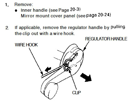

hi all.
was trying to remove my door panel today,
got every thing unclipped/unscrewed except for the Manual Window Scroller thingy.
Heard there is a clip thing beneath it.
Couldnt get it out with my screwdrivers
anyone got any techniques/tips?
thanks!
Old Jun 24, 2008 | 10:04 AM
Default RE: Manual Window Scroller removal
Old Jun 24, 2008 | 12:50 PM
use either 2 screw drivers.... or just go buy a window crank removal tool...
used a clothes hanger, worked perfectly. thanks guys!
hmm interesting. i guess i put my clip on backwards according to the picture.therefore ipush instead of pulland use a flathead to pop it off. something to consider for future. its a cinch.
