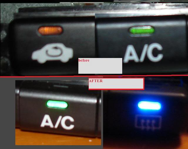

WELL pictures arent that great but heres a quick cut pasted before after... THO im not FULLY done yet... i still have to sand the leds flat on the sides so the ywill slide into the buttons! BUT so far not to bad.... solder job isnt the best cause i cannt find my solder remover copper stuff. ill have to buy somemore. then finish soldering the blue leds and resistors for the backlighting of those buttons... BUT hardest part done
lots brighter!

you will definitely be able to see if it is on. looks great

Addiction, Is there any way I could get you to posta pic of the rear side ofthe A/C control panel? I know a guy who sells premade leds built into resistors and I was wanting to swap all of mine to blue as well. Only problem is whether they will work or not. I bought two of his leds and switched my gauge panel turn indicators to blue and they look great. Before I pull my whole dash apart though, I wanted to see if they would work for the AC controls, or if I should just follow your lead and make them myself. I'd really appreciate the pics.
Old Jul 9, 2007 | 01:37 AM
Default RE: JUST ORDERED. more leds and strips for cluster and HAVAC controls....
ya ill snap some pics later tonight. but for the backlights ya it will BUT for the indicator lights those have to be soldered out and back in as well as resistors.... and any 5MM leds have to be sanded down preaty flat on the sides for them to fit BUT 3MM leds will slide right in thier no sanding needed.... ill post up some pics of what i mean when i get my 1 led sanded down...
