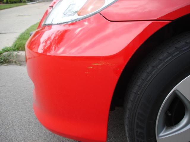

i must have hit a yellow pole that you usually find at drive-thru's, because i saw on my drivers side bumper a few streaks of yellow about 2inches high and about 4 inches wide.
i tried using a rag with water, with intense elbow grease, but nothing budged. any ideas?

buffer and buffing compound, be careful not to burn the paint.

what the guy above me said just buff it out or just use some scratch x or something to see if that will work first. Most of the time those arent that paint friendly so you might be screwed and have to get it painted/ plastic filled if its gouged

Picture of the damage? Is it just paint on the bumper, or has the bumper warped? And any deep scratches? And as a general headsup - if you want to re-paint, you can't repaint one section of the bumper. You must repaint the whole bumper. $200+ fix for a good shop.

its defiantly not gouged it just seems like some paint rubbed on it

Looks like that will buff out man.
And you could always ask a paint shop questions. They can tell you how you can do it yourself. =)
