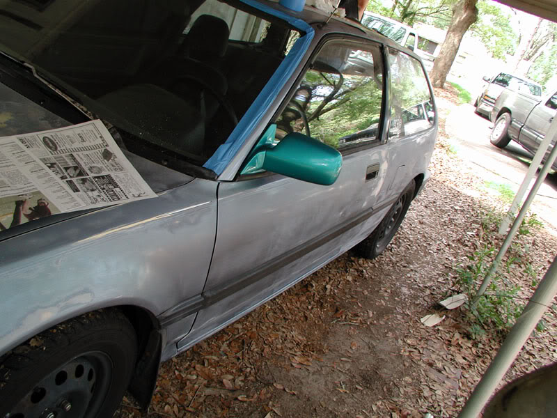

After Sanding, and before bondo sanding.

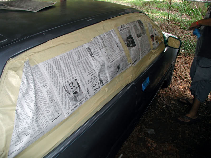

Masking it off..

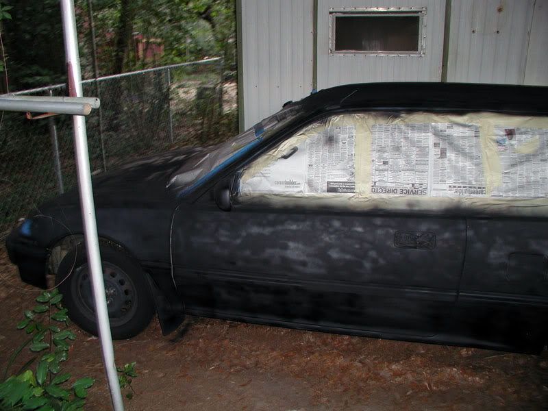

And, After the first coat.. the car still looks like this because I started late sunday, and haven't had a chance
to wetsand it, and give it anther coat.

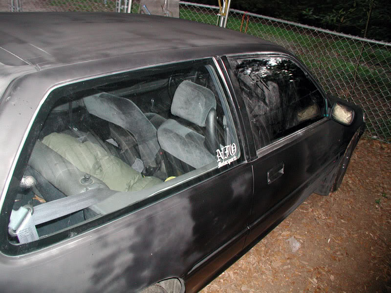

After the Tape came off..

Make sure when you actually paint it you use a sealed paper to mask it. The news print will generate a retarted amount of orangepeel.

wow.... that dont look that good
heres what i sugest... get a decent air system.... and buy a little cheap paint gun... and a gallon of flat black primer.... and spray it on like that..........
ya just dont have a very good spray can finger

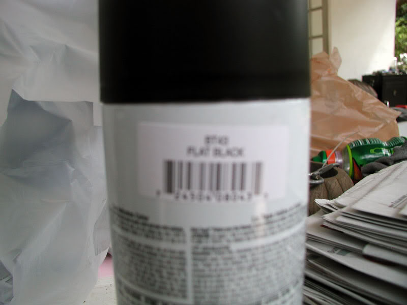

looks like some cans where grey.... some flat black... some black.... and some gloss black......
spray cans arent that great unless they are ALL THE SAME BRAND AND SAME CODE NUMBERS.....
now if you can blend spraypaint it would look fine.....

flat colors are not good choices to paint by a spray can. every imperfiction will be noticed. but then at the same time a car is not a good thing to paint with spray cans anyway. but who knows maybe after several coats it will come out ok
