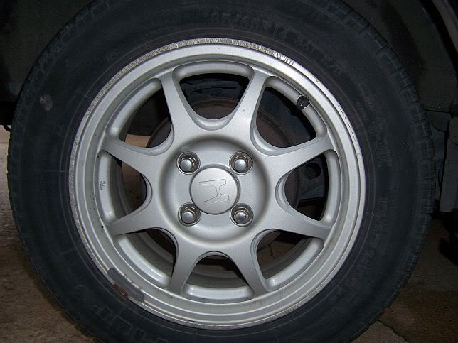

I've got a 98 HX with factory alloy wheels. I was thinking about painting them black. Since they've never been painted and are in good shape, do I need to do anything beside prime and paint?

u need to sand off the paint thats already on there and also smooth out those curb rashes. if u dont, ur paint will peel/flake off in a short amount of time..

Clean those things like crazy. Use some kind of degreaser or something, a scrub brush, and then soap and warm water. Do that before you sand anything

I would see how much a shop would charge you to powder coat them.

That's a really good idea. Powder coating is very strong and won't chip or scratch nearly as readily as regular enamel or laquer type spray paints.

ltkenbo is right clean the heck out of them and when u think you did it enough do it two more times. it will save u time from having to repaint them.
