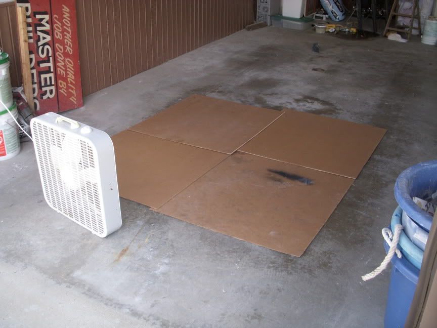

So, first off, set up your spray booth if you're going to make one. Something like this works wonders:
Turn the fan on medium (pointing away from the cardboard. That's kind of important as facing it towards what you're painting will just trap the paint dust in the garage as well as cover the wet paint in whatever dust or pollen happens to be in the air at the time.)

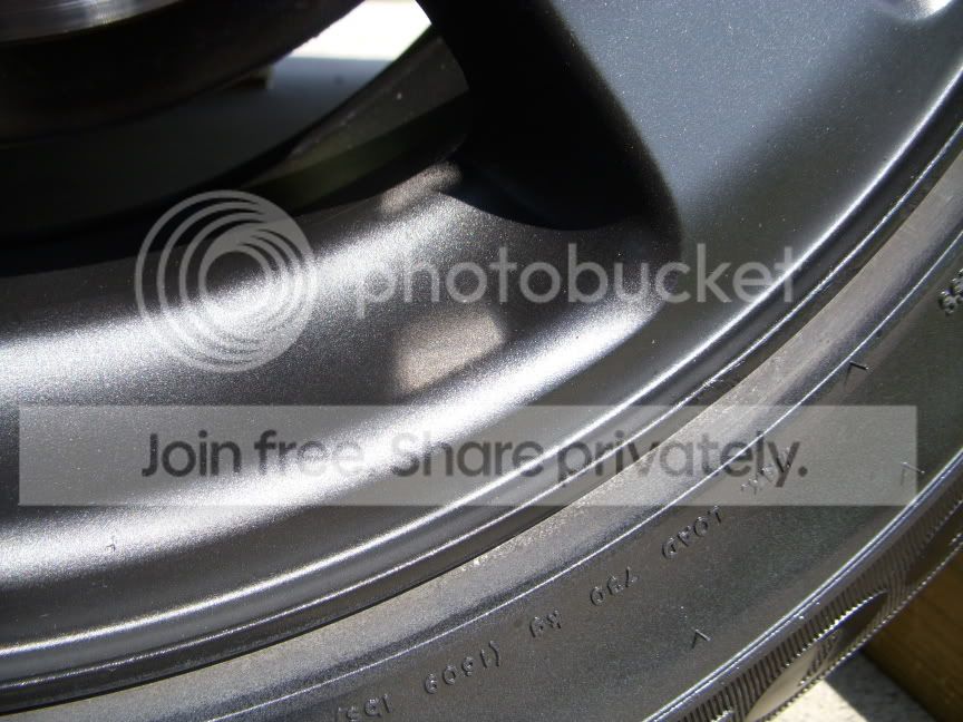

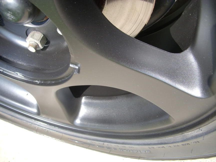

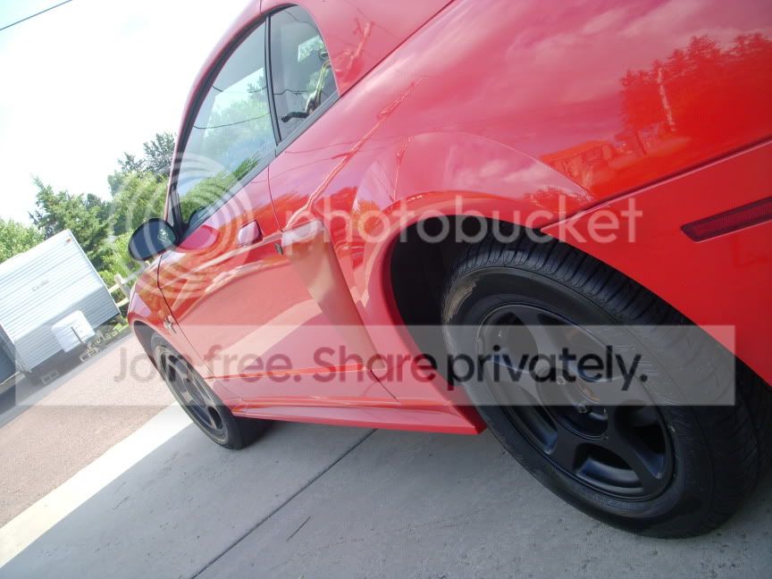

Before:
5-17.jpg?t=1251053093
After:
1-23.jpg?t=1251053121
teasershot.jpg?t=1251053147
