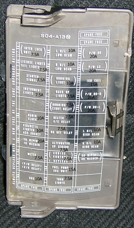

but i also need to check fuses cause i dont have the underdash fuse panel cover to say what these fuses are suposed to go to and afew are blank...

ORIGINAL: rice_eater
Not sure if this helps, hard to take a good pic of the fuse labels. This is from my 94
