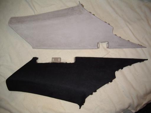

i just did my headliner and all my plastic panels in faux black suade i got from jo-ann fabric for 40 bucks .make sure to use 3M high strength adhesive 90 .my door inserts are next on my list.

is that material close to stock...or is it that stuff that starts to ball up after awhile.

ball up ??? you mean like cotten when it gets worn in that case no but whatever material you use get some uv and stain protection for it.
