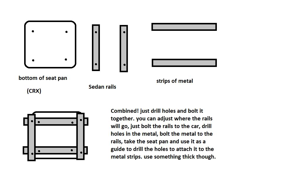

Old Jun 25, 2011 | 10:52 AM
zerojett's Avatar
Posts: 689
From: Saskatchewan, Canada
something like that might work.
but porsche/civic instead of crx/sedan instead. =P

thank you so much. i think i get how to do it know
