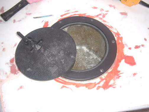

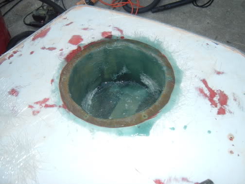

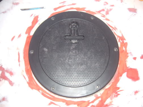

more,
[IMG]local://upfiles/1537/96E3E9F0C85A4452899571023F895DB6.jpg[/IMG]
[IMG]local://upfiles/1537/ADCCF92E4C204961BC7444DB824163FD.jpg[/IMG]

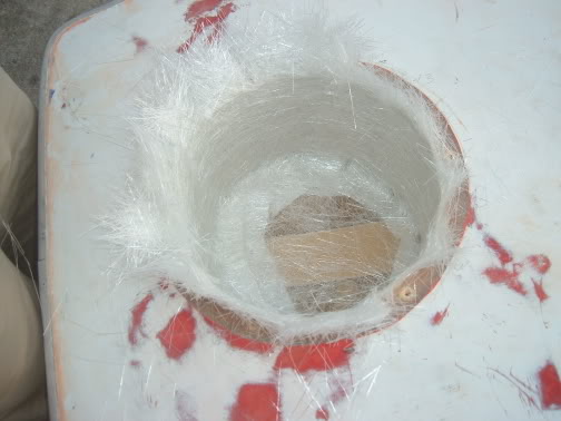

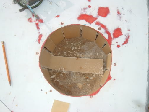

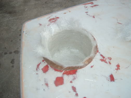

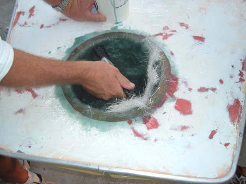

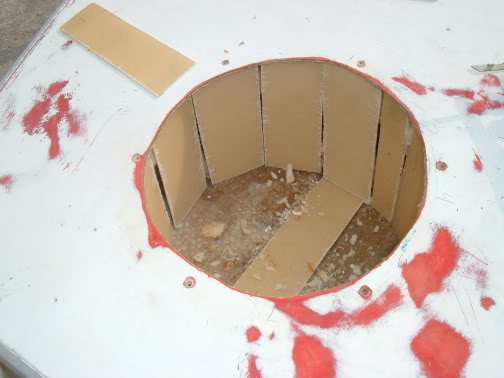

Here are the updates as promised. Dry storage complete. The f/g job doesnt look all that great but I dont care, as long as it keeps shish dry and doesnt hint its ugliness from above which doesnt.
Part one of the cooler is done with the rectangular hatch on top. Part 2 will be sealing it off from the **** pit with a sheet of plastic, then sealed off. Next step, sanding the **** pit down and then the paint job.

Building the bucket...
Bucket finished. The strip of fiberglass on the bottom is to keep the new resin from getting into the ditch of the boat that leads to the drain.
Fitting the fiber...
Fiber fitted...
Adding resin...
Fiberglassing done...
