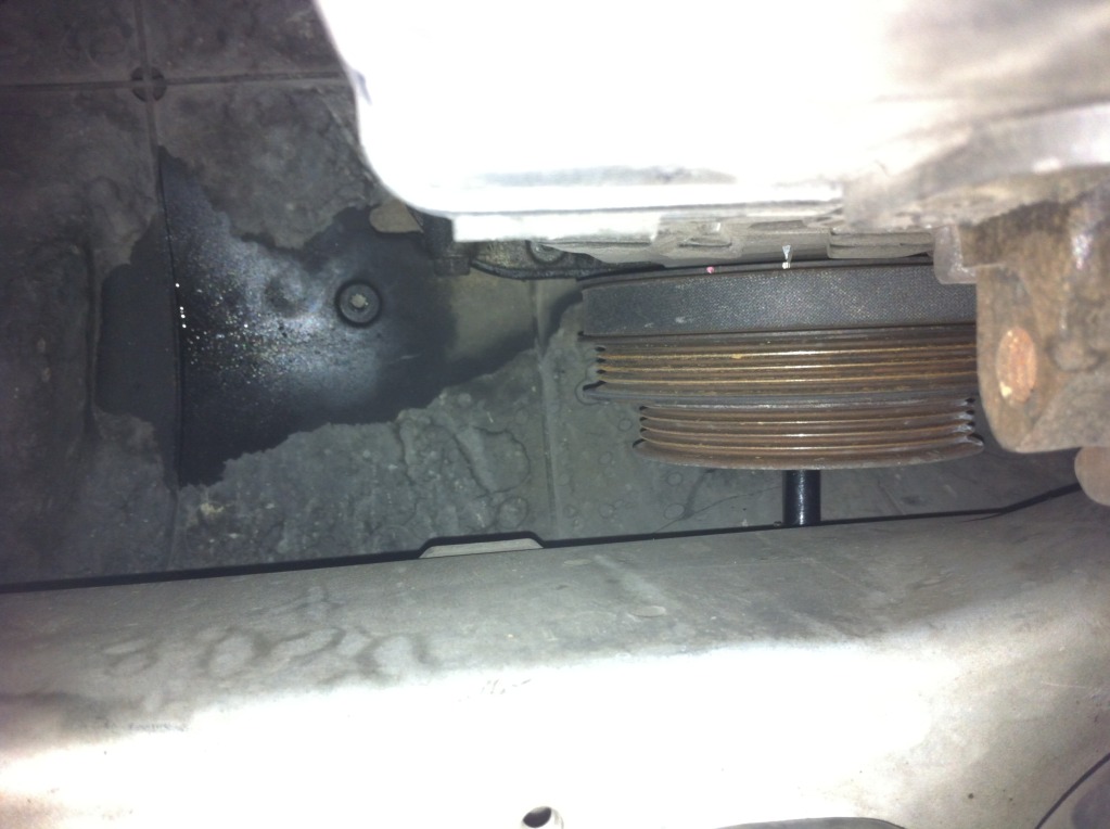

While doing this i checked timing over and over, many (counter-clockwise) turns of the crank. Take a look at this photo, is it just me or does the crank look about a mm off on TDC when the cams are aligned? Should I worry about this? I know its hard to look at it in a photo:
