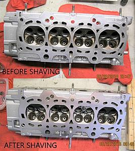

6/30/18 update - I pulled the head again, cleaned the mating surface & got a 0.003" feeler gauge under a Blue Point machinists straight edge in some places. This time I saw obvious breaches between the combustion chambers and the coolant passages. DUHHH... I brought the head to a machine shop in Vegas. For $45 the owner "Israel" hot dipped the head and shaved off 0.006" on a milling machine while I waited (about 30 mins). :-) Vegas is all about SERVICE! :-) I could not get a 0.0015" feeler gauge under the straight edge now! :-) I will update after installation & test drive. Stay tuned! :-)
In the cylinder head pic, the top pic is before shaving, bottom pic is after shaving 0.006"

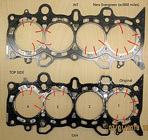

7/2/18 update - I don't think that this combustion gas leakage problem was caused by a failed head gasket. I think that the leakage was caused by head warpage that was caused by overheating. I recently noticed clear evidence of this when I took a closer look at the two gaskets. In the head gasket pic, the top head gasket is the new Evergreen one I installed after only 600 miles of use. The bottom head gasket is the aftermarket one that was on the car when I bought it about 7 weeks ago. There are very similar breach patterns between both gaskets that I marked in red. The aftermarket (Evergreen) gasket would have probably worked fine if I had just shaved the head before using it. I STILL lean toward using OEM parts exclusively on Honda motor vehicles (cars & motorcycles). A personal preference of mine. I don't like to compromise proven high quality. :-)
