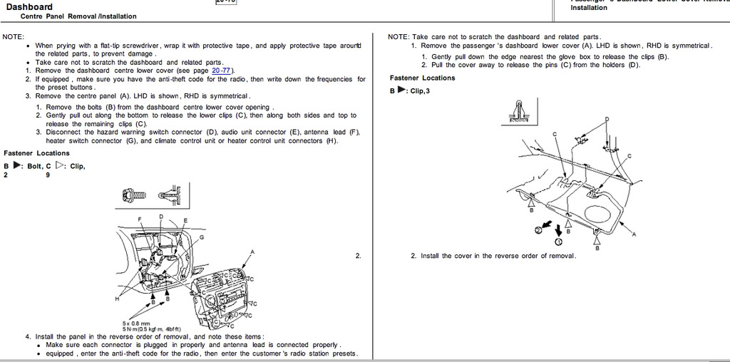

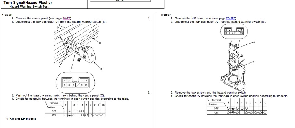

I just purchased an 04 EX coupe and the flasher switch is disconnected and I'm not sure how to remove the interior panel it's mounted to. The previous owner swapped radios before he sold it and forgot to plug in the flasher switch. Thanks.
Old Dec 28, 2008 | 08:29 PM
