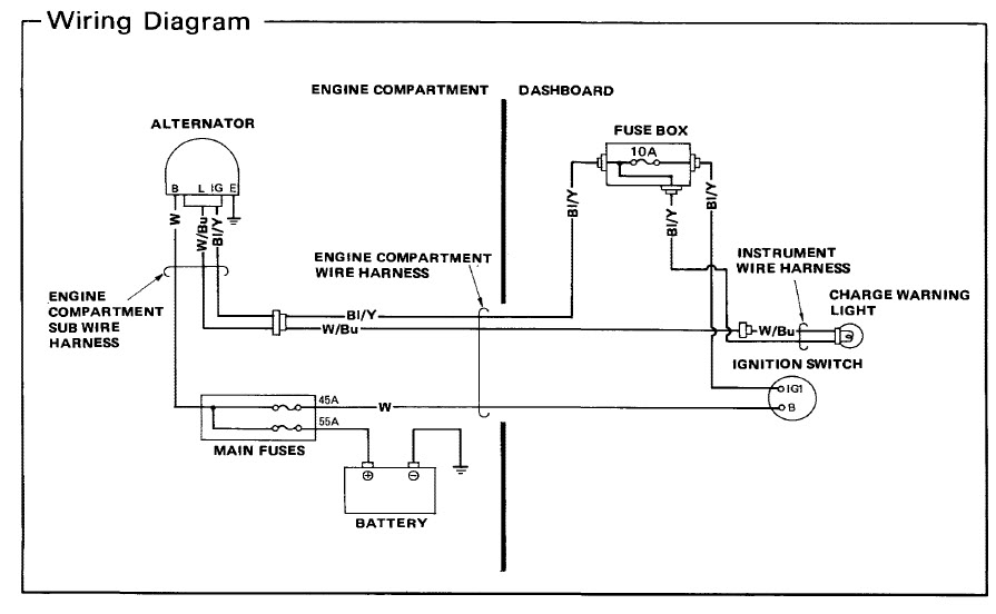

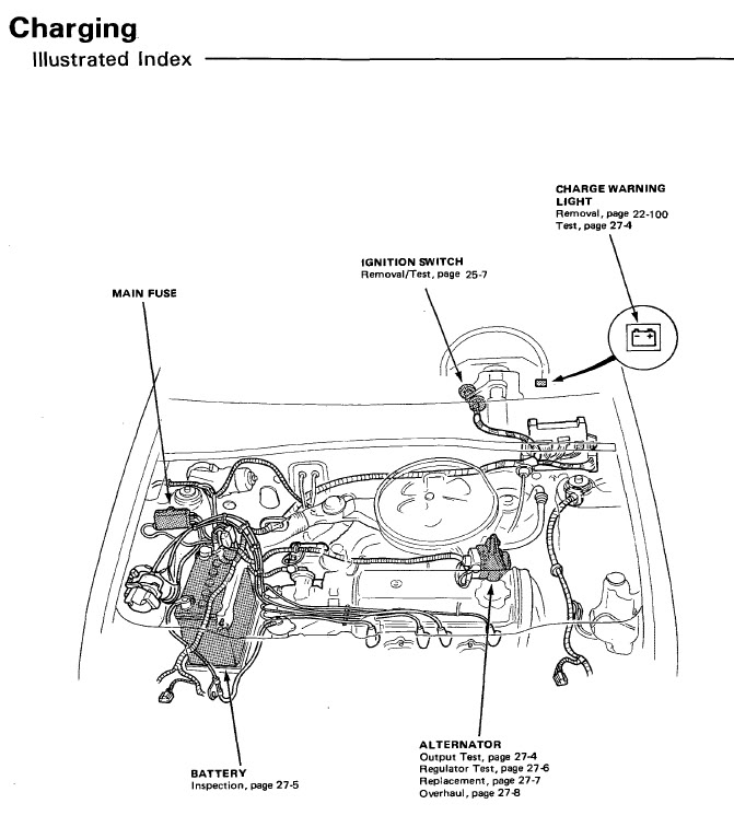

Looking into purchasing an '87 Civic, and I need to hear it run. However, the bottom of the three fuseable links under the hood is shorting out. Does anyone know what it is connected to this fuse so that maybe the short can be bypassed and the engine started up? A wiring diagram of some sort or just some general idea would get the job done.

Just to quickly elaborate:
The fuses are under the hood, on the passenger side. They are covered by a black fuse cover.
The current owner mentioned alternator trouble, is the alternator connected to that fuse?
Thanks again!
Chris.
