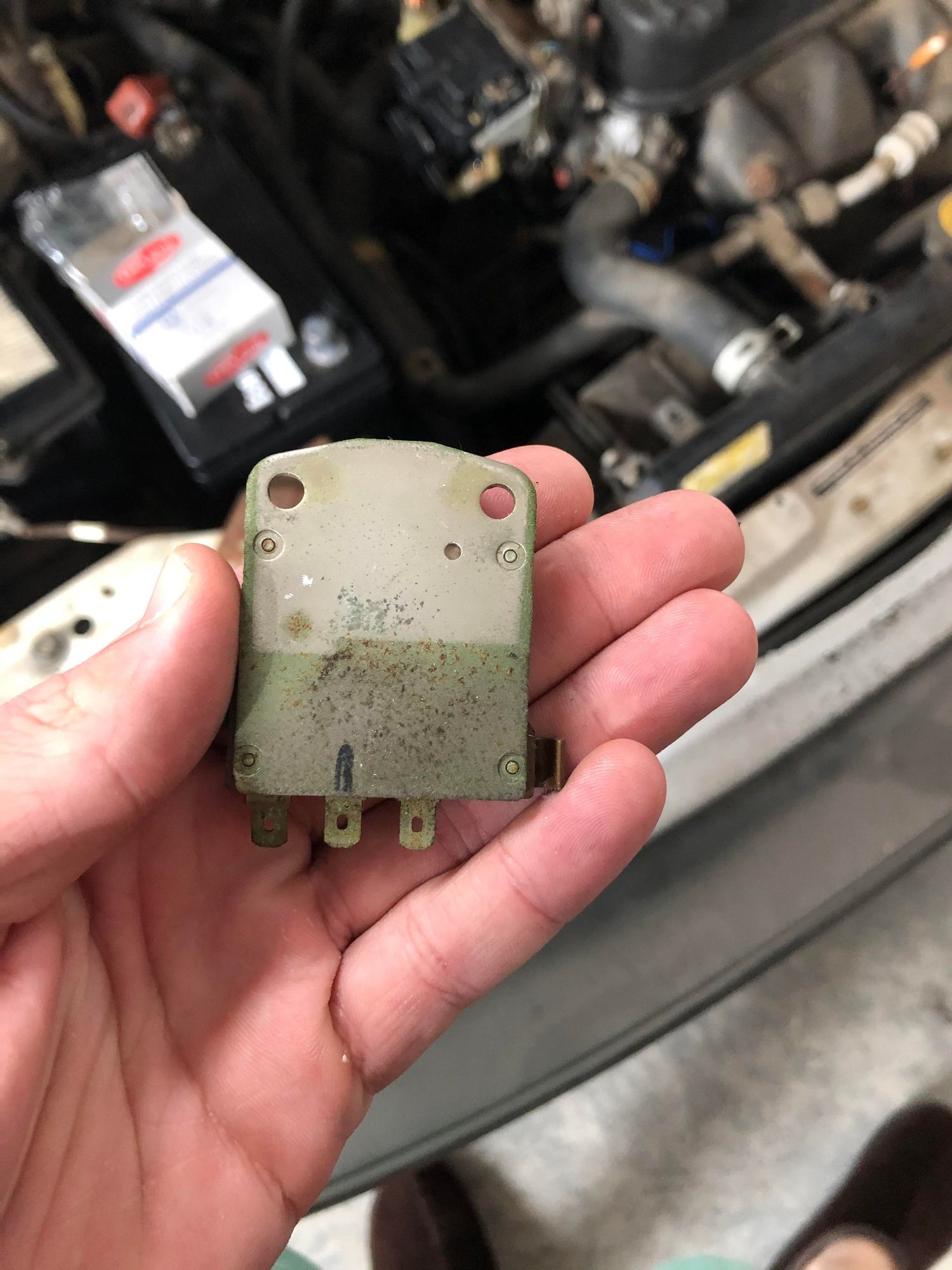

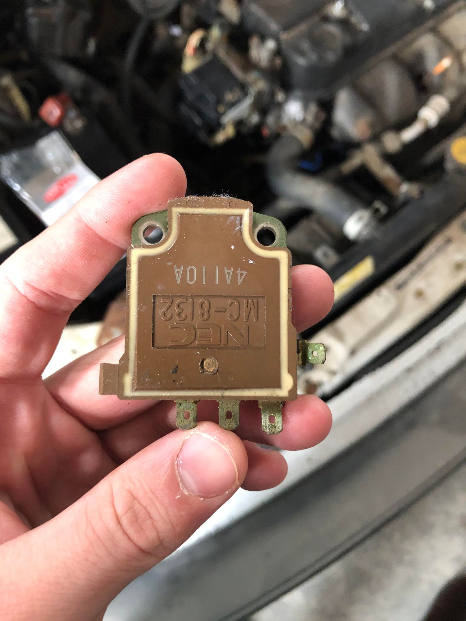

OLD ICM
OLD ICM
it is indeed a four prong ICM, but when i went to follow the steps for testing the ICM from the document you provided, i noticed that the wires are different colors. (from left prong to the left prong) the colorsare solid white, black with a yellow stripe, white with a green stripe and a solid green wire. would you happen to have a testing procedure like this for the 88-91 year models??

ill do some more digging your icm is 86-93/94. 94 started using a different p/n but looks identical probably the same wiring too since 93 and 94 both show both p/n listed. 95-2000 only list the newer p/n.
