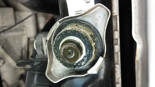

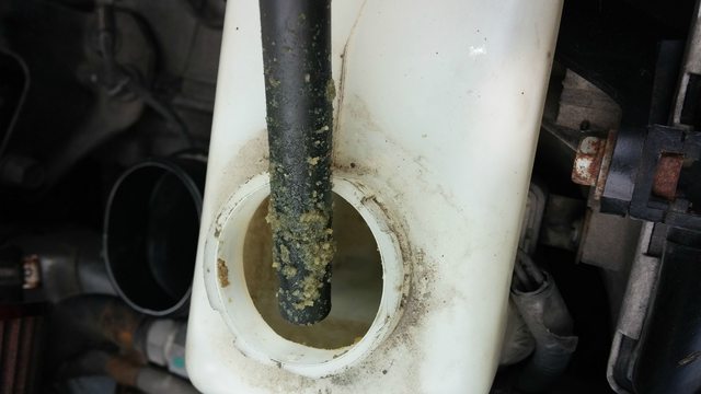

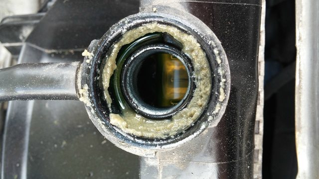

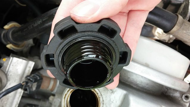

Hello, im new here. I've bought a 1998 civic 1.5 vtec-e, today i opened the radiator cap and noticed some weird looking sludges, might this be just old coolant or something more seriuos like head gasket??? Car starts and runs fine, no overheating (at least from the temp gauge), no smoke, oil cap and oil dip stick looks fine.
Im posting pictures below:

any help?

clean it flush it refill it.
Old May 5, 2014 | 11:30 AM
^That and do an oil change. Is the oil milky?

Originally Posted by cvcrcr99
Is the oil milky?
As far as i can see - nope.

this is what happens when you neglect basic up keep on your car your lucky this didn't cause a overheat.im not saying its your fault because you just bought it but this is a sign that there are other problems that you should have inspected before you bought the car.
