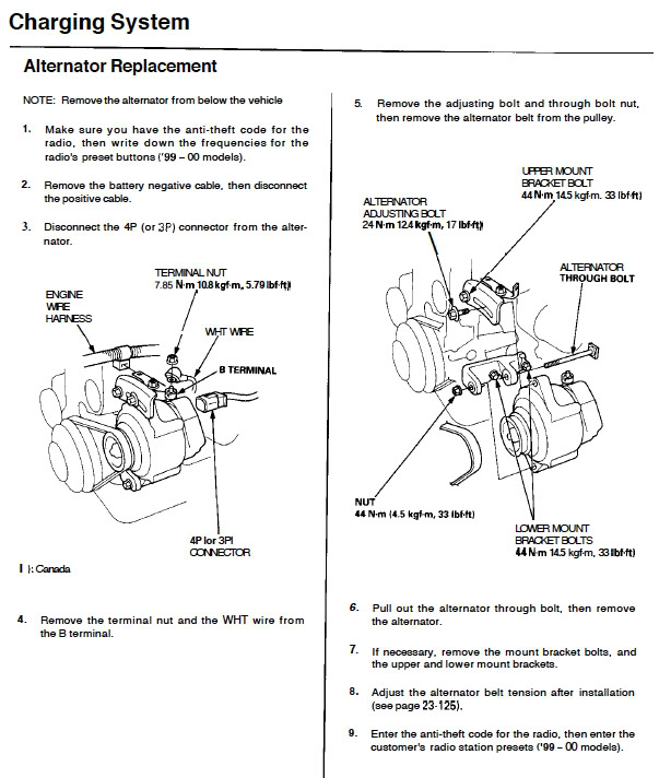

Old Jul 16, 2009 | 06:44 AM
Originally Posted by My04Civic
can he have a schematic ronj?
Well, most definitely.
If the alternator is really making the noise, then put the front end on stands and remove the driver's side wheel and the splash shield. Removal of the alternator is as described in the diagram, except that you must also remove the Lower Mount Bracket to get the alternator out.
