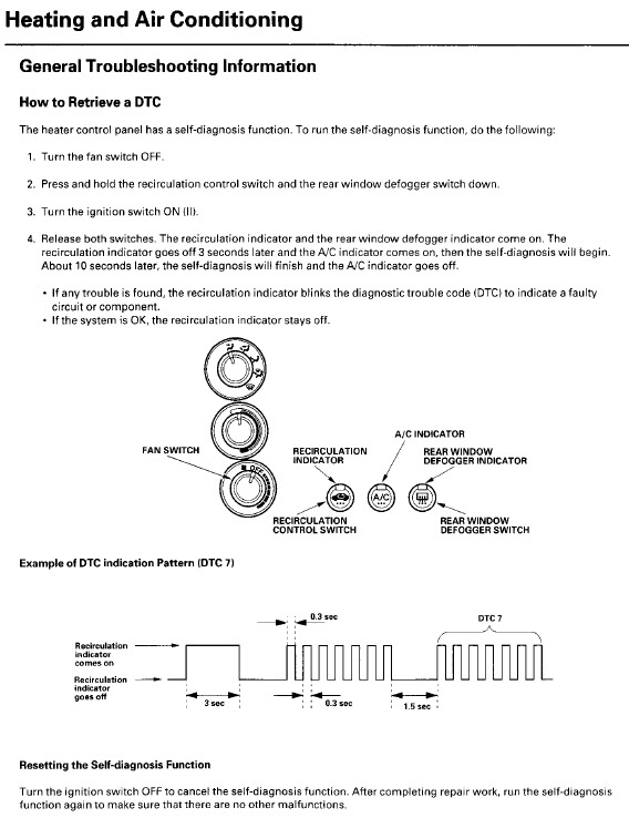

I saw a DTC chart in another thread of a 2002 owner with a similar issue.

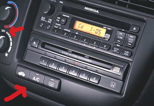

Does anyone know if I can use this same DTC chart for my 2000 model to pinpoint the issue? Attached is a pic of that chart and what my climate control buttons look like.

It's usually the power transistor though it could be the motor. The self test will not diagnose between the two, you just get a code 12. While it is turned on but not working, measure the voltage at the motor between the two motor pins with the motor plugged in. If you have 12 volts between the pins but the motor doesn't run, it's a bad motor. If not, measure from each pin to ground. Getting 12 volts on both pins means it's a bad power transistor. Some parts stores call it the "resistor". If you have zero volts from both pins to ground, check the fuse and relay under the hood.
