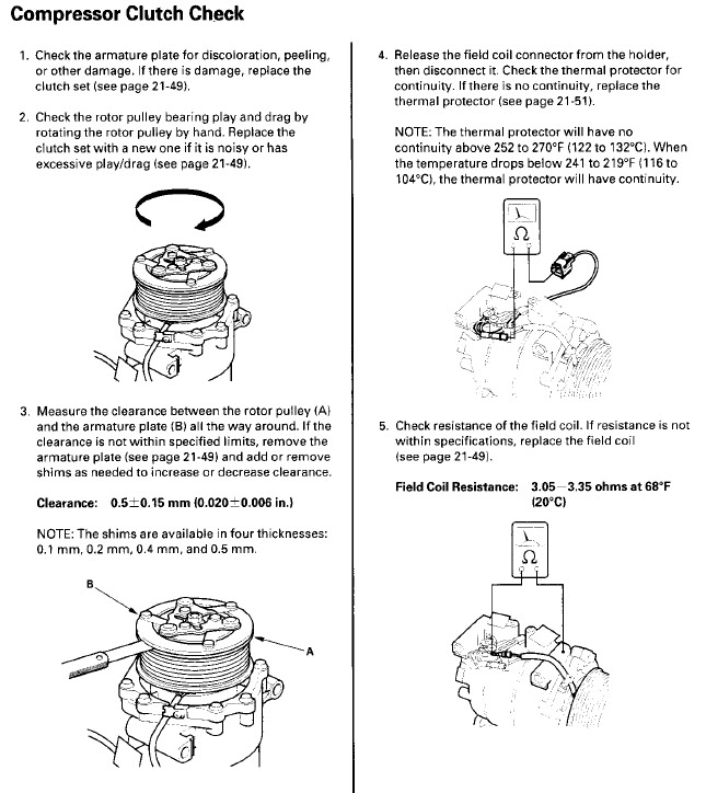

Both the radiator fan and condenser fan should run when the A/C button is pushed. If so, you may want to test the thermal protector on the compressor and the compressor clutch gap.

I think I am good enough mechanically to handle replacing the thermal protector. The compressor clutch test may be a little over my head. How can I test the thermal protector?
Old Jul 1, 2010 | 07:25 AM
Test the unplugged protector for lack of continuity across its two terminals. If it's open, replace.
The armature plate gap can be measured with a feeler gauge and a willingness to work in a tight space.

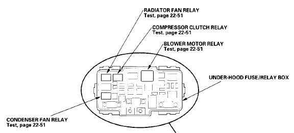

So that really just leaves the compressor relay. Open the underhood fuse box and swap the relay with one of the other ones.

Based on the circuit diagram, it appears that the idle would increase and the fans would run if the thermal protector or clutch gap were the problem.
Nonetheless, checking the compressor clutch relay is still a good idea. The fan and compressor relays can be swapped to test this idea.

Thanks for pulling the diagram, Ron. Diagram shows the old type with thermal protector in series with the clutch, and only one wire connected to the compressor. But the manual posted shows the newer type with a separate thermal protector with it's own plug. I think with those the thermal protector is wired in series with the pressure switch in the low-level control part of the circuit. OP will need to examine the car to see which type is actually in use.
