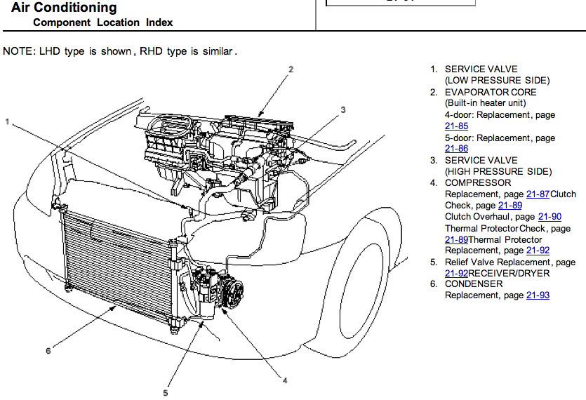

I am having a tough time locating the compressor. Would you happen to have a diagram to help me out. Thanks

Compressor is bolted to the bottom front of the engine on the driver's side where the belts are. Follow the metal line that goes over the engine near the driver's side fender and has a screw cap test fitting on it. The bottom end of that line is connected to the compressor. It may be hard to see from the top with the power steering pump in place. But you want to find the top of the compressor because that's where the thermal protector is. Though if you have the protector with separate plug I don't think that's going to be the source of the problem.
