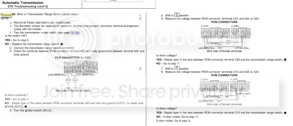

The fact that the CEL remains on while you drive indicates a trouble code is stored in the ECU. Obtain an OBDII scan tool to retrieve the code or take the car to an auto parts store that will pull the code(s) free of charge.
P1706
Definition
BBLock up clutch does not engage
Probable cause
BB1 - open or short circuit condition in the gear selection switch circuit
BB2 - Poor electrical connection
BB3 - Failed gear selection switch
I guess if I had to guess one I would go with #2...my only concern is that this will get my gauges fixed. Last time, when we got the code saying there was a faulty computer, we replaced the computer and temporarily fixed the CEL, but I just want my fuel gauge to work so I can drive again.
