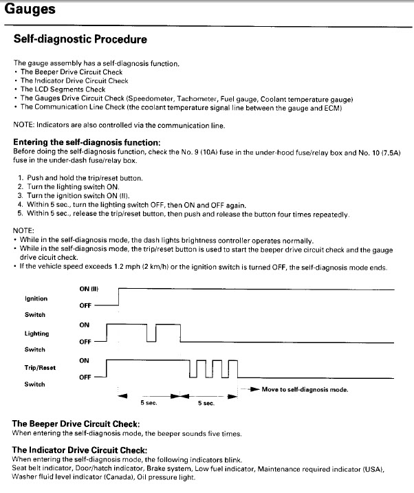

I need help with my 2003 civics fuel guage. Its reads full one min the empty the next, sometimes it works fine. The dealer wants to sell me a whole new fuel pump thats big $$. I think all I need is a new sending unit but I dont know. Can someone tell me which way to go to get this repaired? I really need your help! Thanks

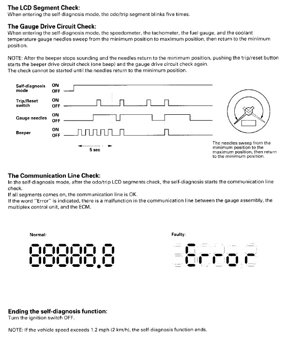

Start by doing these tests:

What makes you believe the problem is the sending unit?
