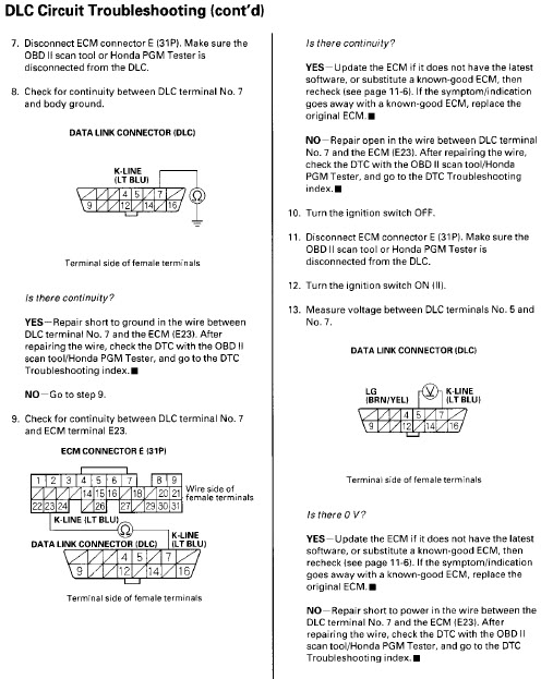

Sounds like an ECU problem. Some civics have a fail-safe circuit that will get you home but nothing else. Would you be able to find another ecu to swap? Maybe test the basics first: fuses, relays, lose connections, etc.
Old Jan 7, 2010 | 10:24 AM
