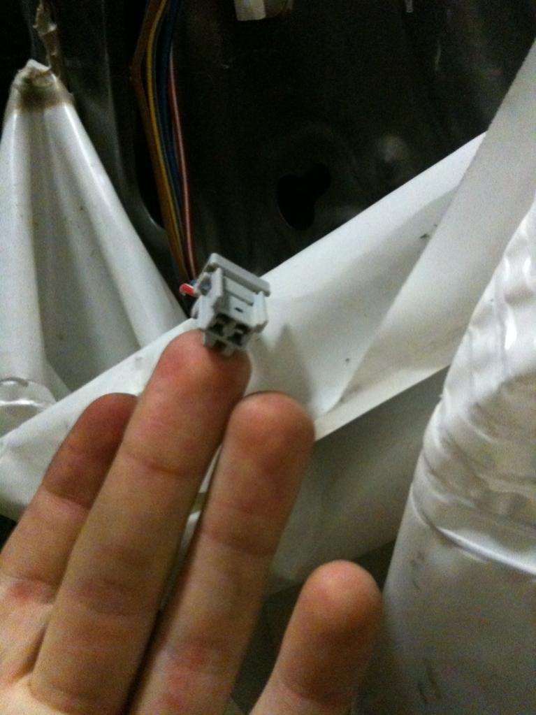

Tore down the rear right passenger door this afternoon after the window wouldnt roll up... at all. No motor sound, nothin. Couldnt even wiggle the window up to shut it. Went ahead and removed the old motor\regulator unit and ordered a new one without thinking. However, upon testing the two pin connector that the stupid thing plugs into .... i get no current. Zero, zip, nada.
Now, i started off with a headache this morning, this made it worse, which leads me to why im here. Am i 'doing it wrong', have i lost my mind, or am I just going to have to suck it up and run a new set of wires.
Picture of the stupid little thing is below.

I had a car with the same problem. I tested things and found that the drivers master switch went bad, found a used one for $10 put it in and all worked fine. The way I tested it was to put direct power to the up side of the motor then the down side all worked, then I knew the switch or wires were bad. The wires all looked fine, must be the master switch. I changed it out with the used one, no more problems. Hope this helps, keep us posted on the progess. Thanks,

2010civiclxWell, the new motor\regulator comes in tomorrow. I'll hook it up and see if she purrs. I can always RMA it back if its the switch.
Thanks for the input, its amazing what we learn from second opinions.
