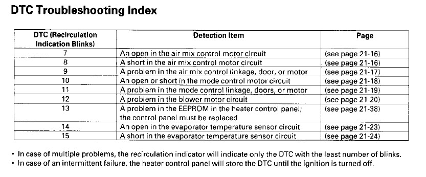

First try to retrieve a DTC (picture 1). Post any DTC you happen to get.

Thanks Ronj, I was hoping you would chime in. You helped me several months ago with the door locks on my daughter's 98 Civic.
I ran the diagnosis and the DTC came back with 12 blinks. Do you happen to know what that means?
