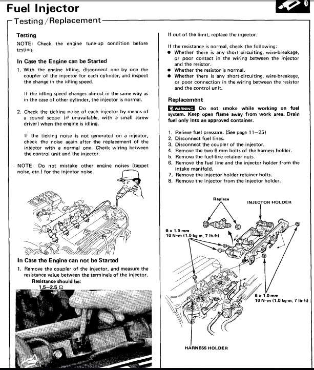

I misunderstood your comment.
Maybe this info will help with further troubleshooting of the injectors:

ok i have checked all 4 injectors and they all read the same 2-2.1 omhs still dont have any ideas

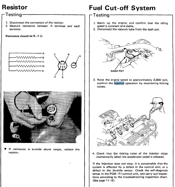

I generally consider the ECU last. Did you already test the resistance of the resistor as shown in the first diagram?
Also, I wasn't sure that I really understood this comment you made in the first post:
"PGR-FI light flashes 2-2-3 and no fault codes on the ECU no lights light up at all"
For example, how does this statement relate to this diagram:

no i have not done that test but ill try it tomorrow when i get off work.

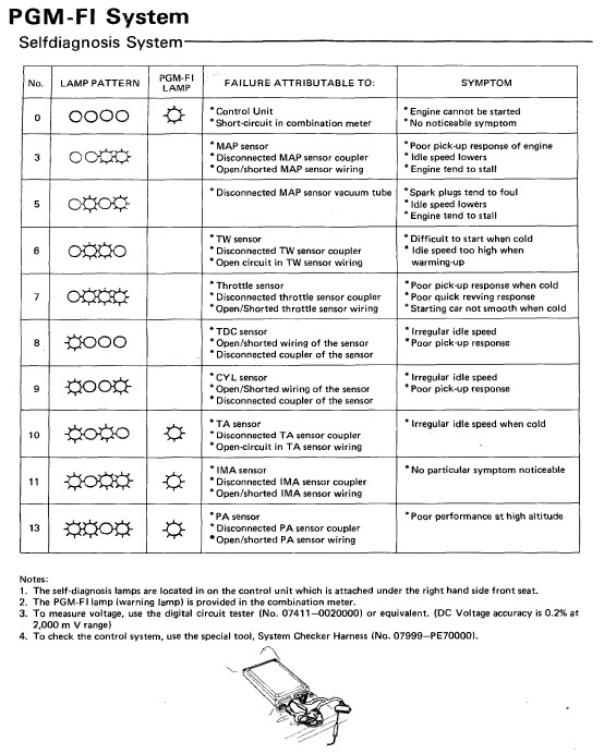

Ill try to explane the PGM-FI light. when i turn the key on all the normal lights are on then they go off and the PGM light stays on and then it starts to blink twice and then a pause. then two more than a pause and then three times it blinks and then keep repeteing that.
Old Jan 8, 2009 | 05:13 PM
I really don't know what the blinking pattern of PGM-FI light means. I can't find this described in the service manual; however, the fact that the PGM-FI lamp stays ON indicates a problem. This together with the fact that the ECU (Control Unit) does not blink a code would suggest a code 0, which indicates malfunction of the ECU (as you mentioned earlier). You may want to try to purchase a compatible used ECU from a salvage yard to test whether your ECU may be bad.

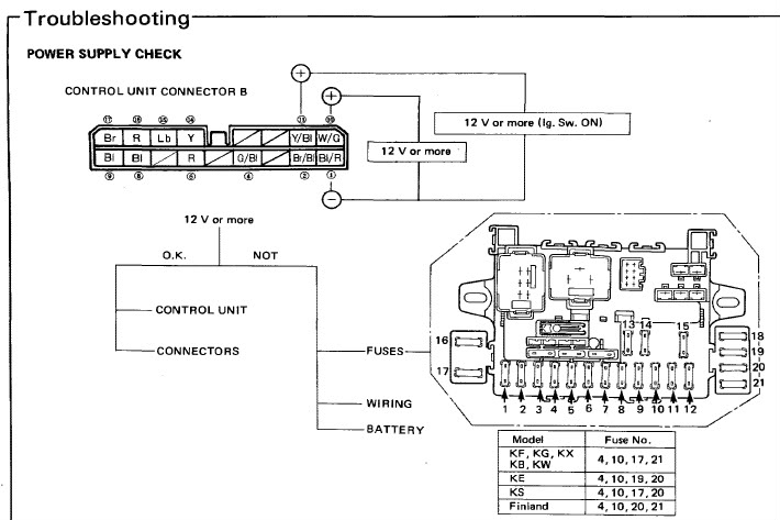

Here's an additional test for you to run on the Control Unit:

ok so what ill do is ill pull the one out of my brothers car he has the same ECU in his. but i am not really understanding the whole powersupply check
could you explanine?
