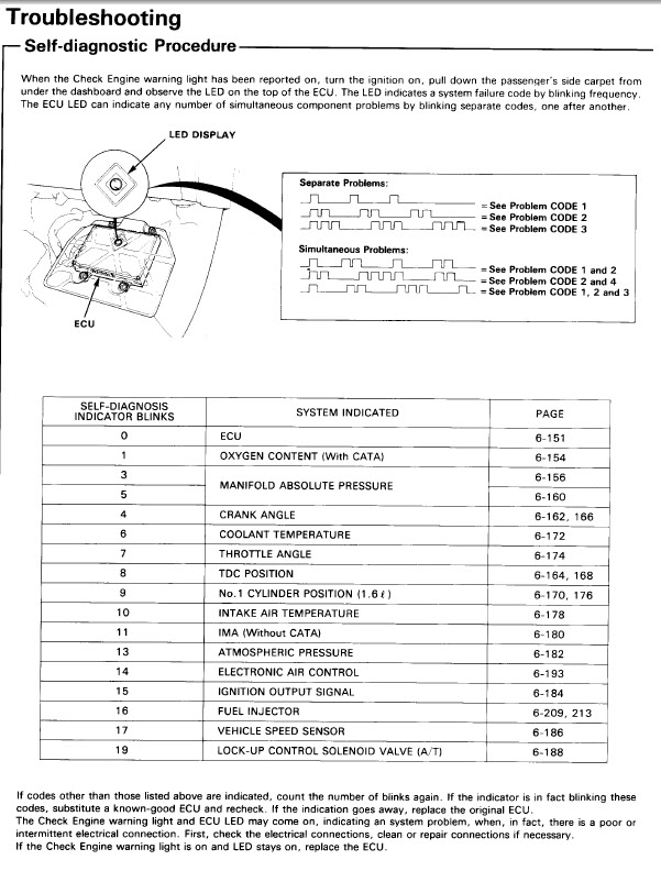

Do you have a fuel-injected or carbureted engine? For the former, pull the front passenger carpet back and check whether the LED of the ECU is blinking any trouble codes.
