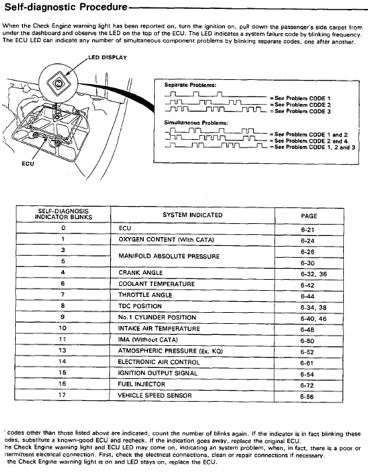

Is the LED of the ECU blinking a code?
You may have a faulty fuel pump or clogged fuel filter. To test, measure the fuel pressure.

I do not have any engine codes when the key is to the II position. I will test for pressure this afternoon. I just went out to the car and tried something else. I turn the key to the III position to start the car and press the gas the car turns over, kicks off, revs up and dies. While it's fired up if I turn it back to the III repeatedly and press the gas repeatedly (not good for the starter I'm sure) it will continue to kick off each time I turn it to the III position and the starter turns the motor. As soon as I let it return to the II position it stops. It almost seems like it's a vaccuum issue but I"m not sure. Any other ideas to try besides the fuel pressure? While I'm in there this afternoon I might as well try as many things as I can.

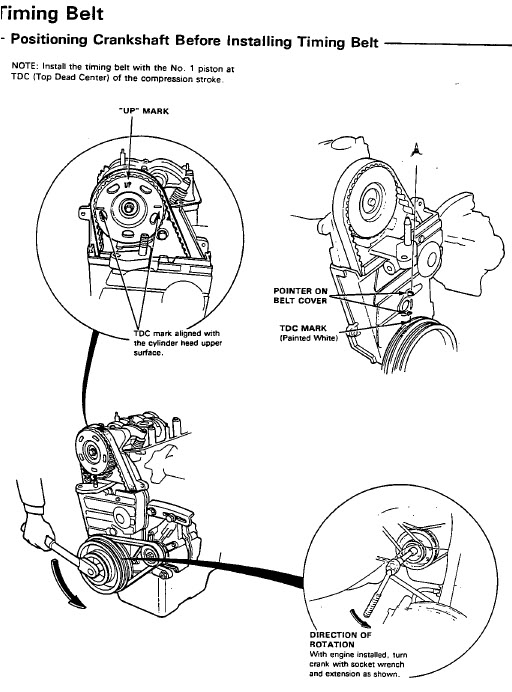

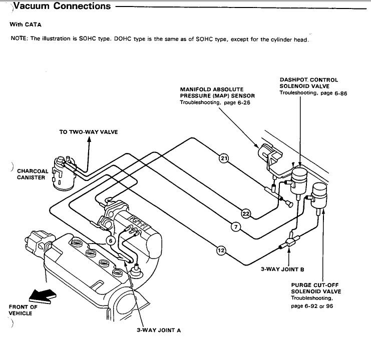

As you have already said, you need to check the hoses and connections for vacuum leaks. You might also check whether the timing belt has slipped, causing the cam and crank not to be synchronized at TDC.

could it also be the carburator? did this model have a IACV or any other controllers to clean?
Old May 24, 2008 | 09:37 AM
Default RE: 89 Civic starts, but stops
ORIGINAL: mundy5
Yeah, a bad dashpot solenoid valve or dirty EACV are other possibilities.

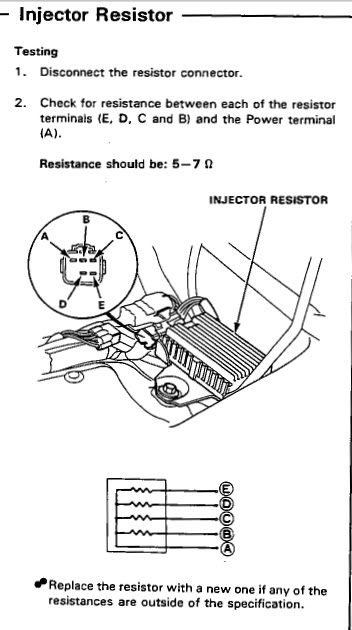

The main relay is unlikely to be the problem given that the fuel pressure is fine. By the way, how did you check for spark?
In the meantime, check the injector resistor:

I checked for spark by doing the old chainsaw/lawnmower trick. Pull the plug and hold it close the chassis while someone turns the key to III. I checked all of the plugs this way and all had spark. I will check the injector resistor tomorrow in the morning and report my findings back to the forum.
