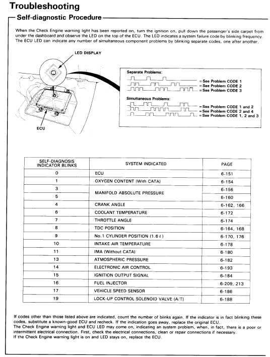

Old May 25, 2010 | 07:32 AM
Turn the key to ON(II). Do you hear the low humming noise of the fuel pump priming in the rear (gas tank)?
Click spark link in my signature to learn how to check for spark.
Any CEL codes?
