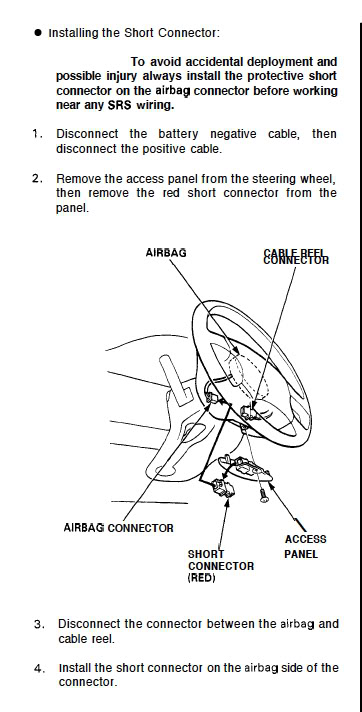

I plan on testing the switch in the morning. The diagram says I need to use a short connector if messing with the SRS. Do I need to do this and is it a special tool?

The red short connector is located at the rear of the access panel:
