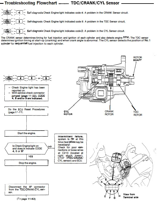

All the position/timing sensors for a '94 are inside the distributor. There is no sensor on the crank. Three sensors in the dizzy feed pulses to the ECU. The ECU generates a pulse at the proper time based on those readings which drives the igniter (ICM) module to fire the coil. That's basically the whole system as far as making sparks.

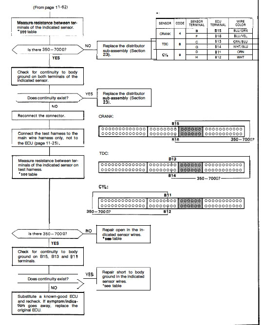

Let me respond to these very helpful ideas. First the test light I use for checking spark shows exactly what I'm getting. If I do it caveman style I do not see any spark at all. I grounded it to the ground wire up front, the valve cover, the battery, and I checked at nightjust to be sure I wasn't working all day and too tired to see straight. Then I pulled my Snap-on sparktest light out my box and tryed it and only got the spark I've posted earlier. It's getting fuel I popped off the banjo bolt on the filter andlet it blow some fuel in the engine compartment (by accident). I swapped out the main electricrelay still same.The timing belt was checked also TDC everything lines up perfect. I'm getting code 4 which is a crank position senser. I put 2 new distributors on this car and tryied my buddies just to be sure I know it has a cam position senser in the disrtibutor. ButI got this car usedand the engine block numbers are ground down on the front so this could possibly be aswap still 1.6 sohc from a previous owner. So It might be a newer motor maybe with a crank position senser(maybe a 1996 or newer lower end and 1994 head. I need to look at this a little closer and some morevoltage tests butIcan't look at it till Thursday. Thanks for all your guys help. I appreciate everything you guys are thinking of but I know its to diagnose a car without even seeing it. Thanks.
Yeah, focus on the code 4 and the potential block and head incompatibility issue. They may lead you to the solution. If no incompatibility exists, then carefully troubleshoot the circuitry of the CRANK sensor.
