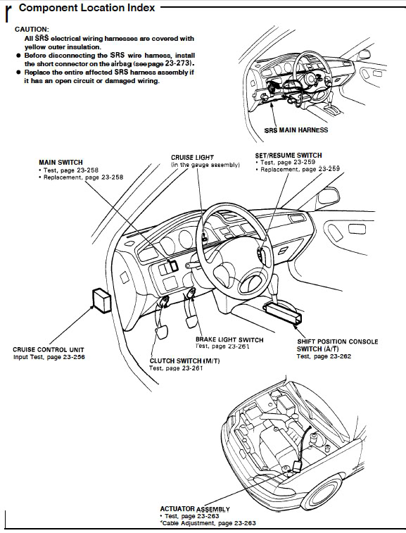

Start by checking the fuses:
Next use your multimeter to do the control unit input tests:

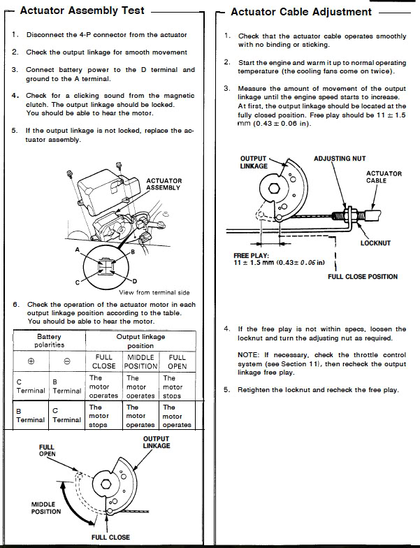

Have you inspected the actuator? Are the actuator cable and plug in place?
Is the CEL ON? Do the speedo and tach work?
Note that the solution to your cruise control problem may not be obvious. Rather than guess what the problem may be, use a multimeter to run through the input tests in the diagram. This should pinpoint the specific problem.
