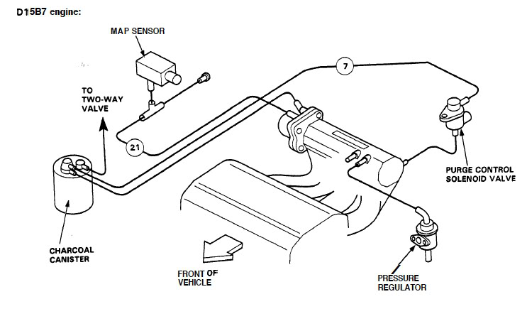

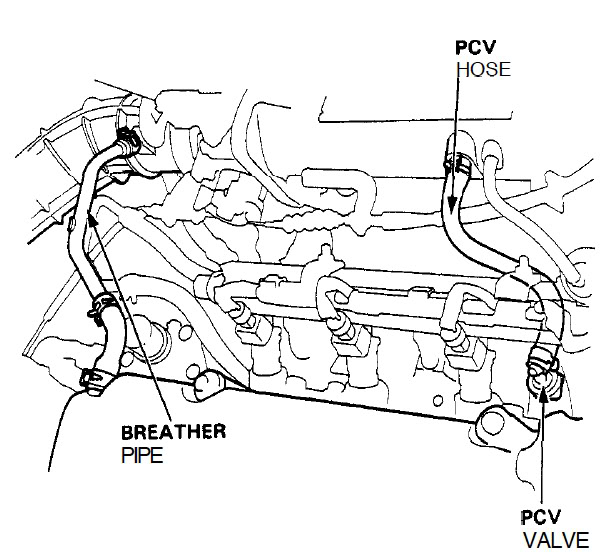

i am getting spark from all 4 and it is priming. the one problem is the PCV hose is broken from the end that is not in the valve itself and I cant figure out where the other end goes. do u have a pic or diagram of where it connects from before it goes to the pcv itself?

PCV hose routing:

its been a while with the filter. hey maybe i am just slow here i apologise, so what is the large canister under the fuel pump that has 3 hoses going to it? that is the one that is broken.
maybe i was wrong. but at the top of that canister has pcv on it.
