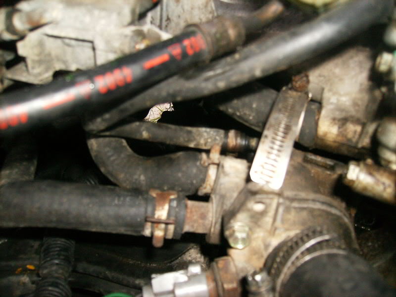

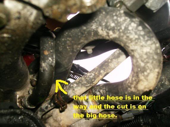

ok well i just got back from driving my car and guess what!!! HOSE BLEW!!!! and its one i didnt even think would of!!! i got pictures from top side, and bottom side... and i will show where it blew at if it helps.... and what would cause this???

That looks like the previous owner cut off the end of the hose and reclamped it. That hose is probably the original one that came with the car, and the whole thing has gone soft. It's the same size as generic heater hose but you may need to buy one from the dealer that's pre-bent into the U shape.
Do not keep driving while your temperature gauge is more than the normal level of halfway up. You risk engine damage even if it hasn't gone all the way to "H".
