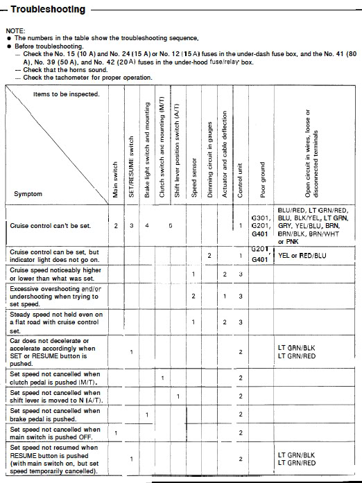

i have a 95 ex that cruise dont work on, i have swapped everything from dash button to steering buttons and the big unit under hood took it off brothers car that works purfect, all vacume lines are hooked and cables are hooked and not broke,the light doese come on that is on the dash when you press it but nothen else happends when you try to turn it on by the steering wheel buttons what should i look for? if wires which ones or is there a computer or something n where would it be located?

Have you checked under-dash fuses 15 and 24, as well as under-hood fuse 42?
To download the 92-95 Civic manual, click the manual link in my signature.

Doing the input tests detailed in my post above should identify the problem.

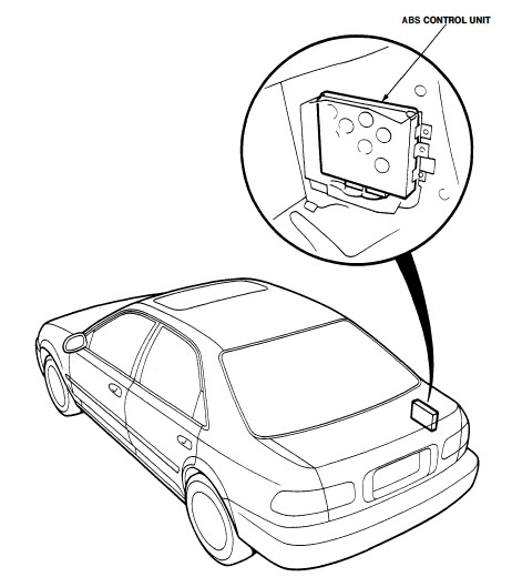

ok thanks.. i knew the cruise control unit box was somewhere in the car.. I'm still trying to figure out what the big box thing is that is in the trunk on the passenger side my lx didn't have that..
