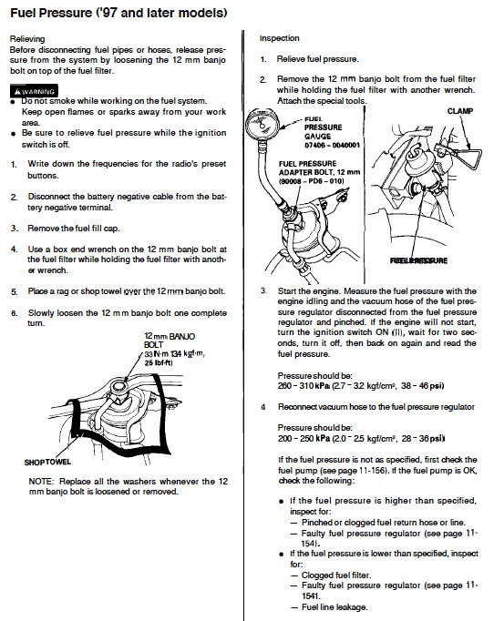

Based on the information you provide, you may have a fuel system problem. You should measure the fuel pressure to see if it is out of spec.
