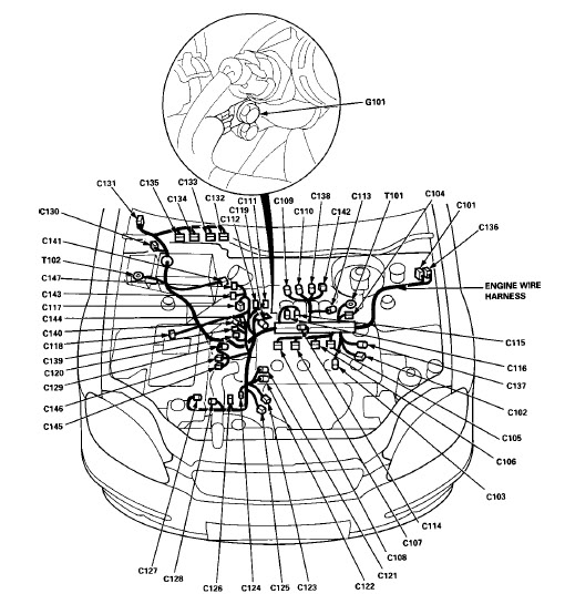

Definitely check the important G101 ground wire attached to the thermostat housing. Ensure that it is both clean and tight. Also check fuses 44, 31, and 13 to see if they are loose or damaged.

Ground is clean and tight, no corrosion on it. All fuses fit tight, visual inspection and used a multimeter. The CEL is no longer staying on since I ran the OBD scanner on, when I changed the setting in it, it cleared the CEL and this was no the code clear option it was just the option to set it for a car that was "Not running."
