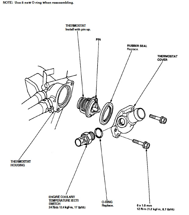

If the radiator fan never runs when the engine is hot yet runs continuously when the a jumper wire is placed in the wire harness of the coolant temperature switch located in the thermostat housing, then the said switch is bad and needs to be replaced.
I am not sure from your information whether your radiator actually has a leak. If you are absolutely sure that the radiator is leaking, however, then replace the radiator and disregard the information below.
Don't worry about testing the thermostat. Just replace it because its pretty inexpensive. Likewise for the radiator cap, replace it with a new one. Before you install the new thermostat and radiator cap, top off the coolant in both the radiator and reservoir (when the engine is cool). Next bleed the cooling system. This is done by loosely installing the radiator cap, turning the dash heater ****/lever to fuel heat, starting the engine, and letting it idle until for approximately 15-20 minutes. Then turn the engine OFF and top off the coolant again in both the radiator and reservoir.
If the engine does not overheat during the bleeding procedure, then drive the car to see if the engine overheats or remains normal. Hopefully the latter occurs. If not, please let us know immediately. By the way, never let the engine temperature reach maximum HOT on the gauge.
