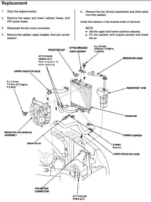

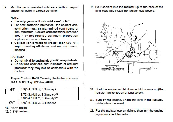

I was worried when you stated that the leak was from the head, which I thought meant the engine head (=bad). The video clearly shows a MAJOR leak from the top of the radiator. Remove leaking radiator and install a new one as shown in the diagram. You then need to refill and bleed the system:

By the way, don't bother removing the drain bolt. Just drain coolant from the radiator tap. That drain bolt is nothing but trouble.
Replacing the radiator should both fix the problem and make you love your Honda again.
