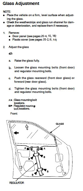

Spray some silicone lubricant into the rubber side channels and adjust the glass:
