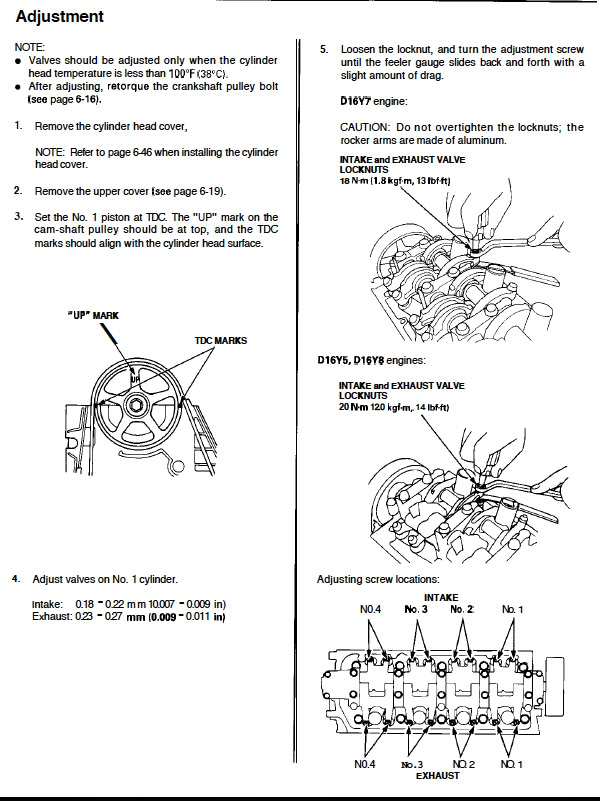

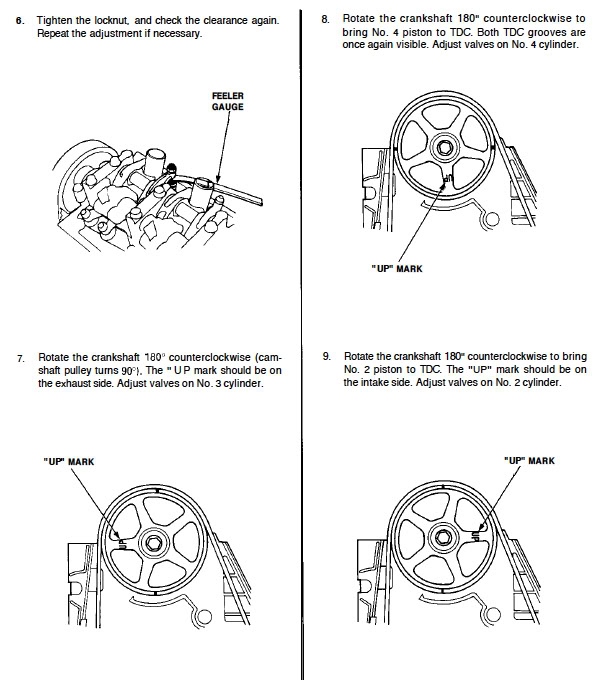

Old Mar 22, 2009 | 03:09 PM
Yeah, make sure also to draw a third of a Seafoam can through the brake booster vacuum hose.
