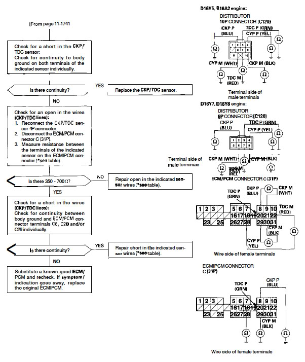

Maybe my ECU is faulty? Is there a way to check ?
Old Jun 7, 2009 | 11:26 AM
  #22
jonnyj's Avatar
Joined: Jun 2009
Posts: 13
The CEL never goes off, even when I am driving.
Old Jun 7, 2009 | 11:33 AM
  #23
AGAIN, the CKF sensor not CKP sensor is under the timing belt cover, so you needlessly replaced a good CKF sensor.
Regarding CKP code P0335, you need to check the wiring before considering a bad ECU. Here's how to troubleshoot:
