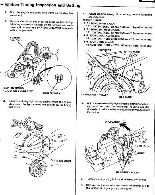

Also, here's how to set the ignition timing:
