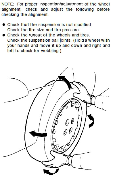

Old May 10, 2008 | 11:38 AM
Default RE: Alignment Problems
ORIGINAL: hjm456
Anyone please?
