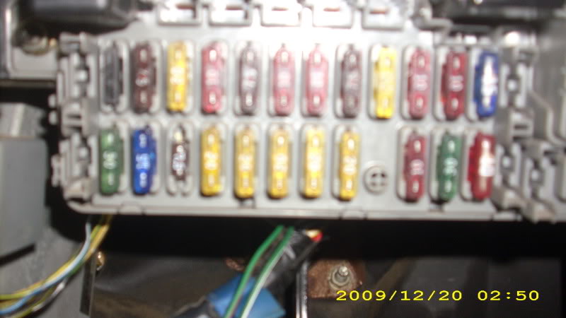

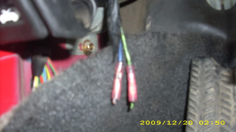

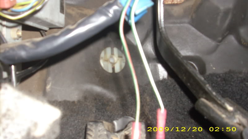

Old Dec 21, 2009 | 05:00 AM
alcala1219's Avatar
Joined: Dec 2009
Posts: 7
GRN/WHT-GRN/RED
GRN-BLU
I found these wires hanging behind my power block under the dash
Any idea????
I have no wiring diagram to see which pin it goes to and i remove the block to look for any altered wires or empty connectors but i found nothing none of them have a ground
