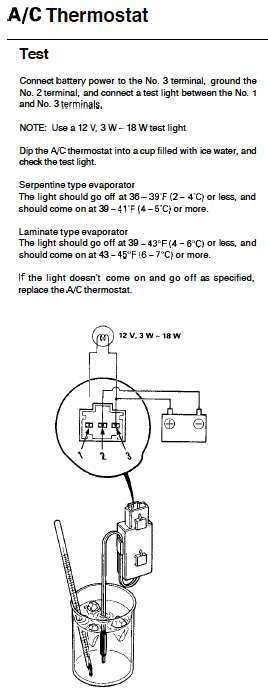

Old Aug 21, 2008 | 08:58 PM
Originally Posted by taylorisafop
I cannot locate fuse 56, the fuses under hood aren't labeled.
How can i test for thermostat/fan switch?
