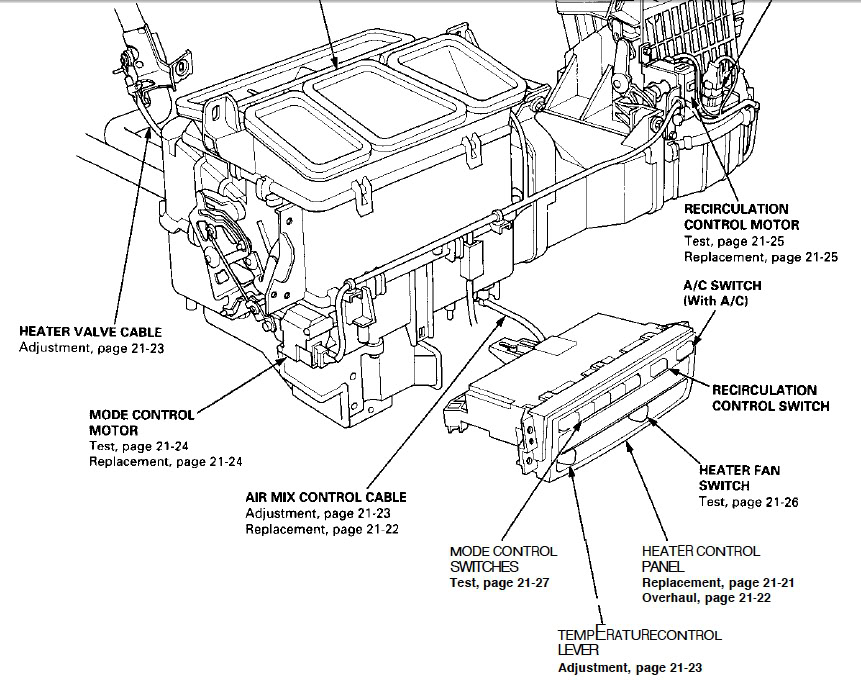

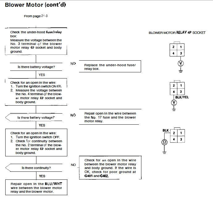

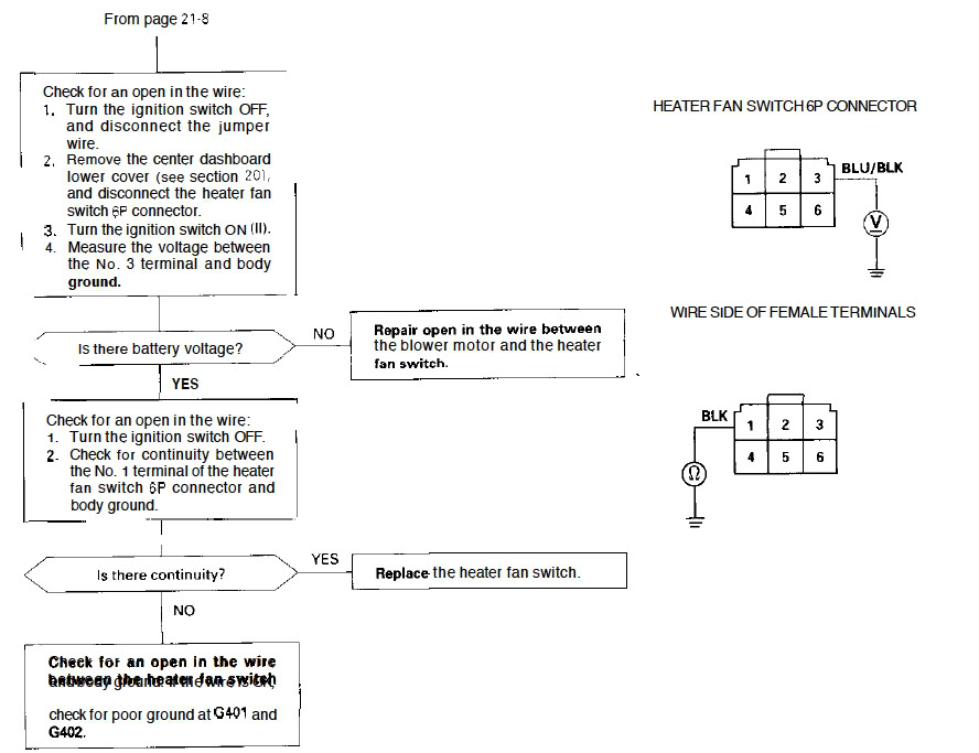

Check the fan switch with a multimeter (see diagrams above and below).

Hm.. I'm not sure on the state of the condenser fan. I'll have to see. As for now, is there anything that connects in the dash, a relay sensor, or something that could effect my blower? As stated before, the A/C light no longer turns on and I'm not receiving any air from the vents on ANY setting.
Also, I'm still in need of how to jumper the radio plug in order to allow my dome light to activate when I open the doors. Possibly related problems?
