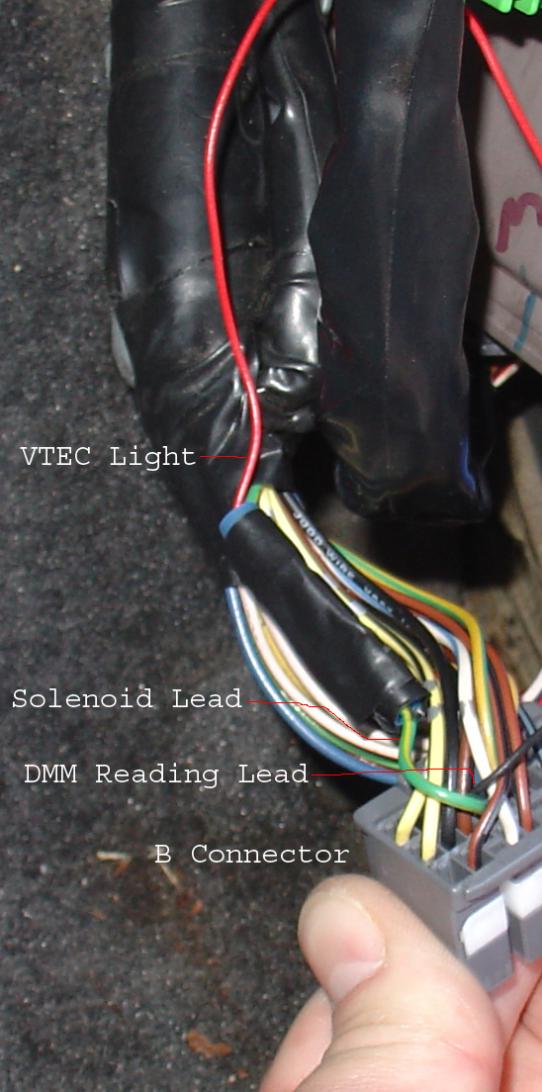

Where exactly is the VTEC light wire spliced into and what did you touch with the multimeter probe to measure voltage. I am trying to identify other possible causes for the problem besides the ECU, even though in the end it may be responsible.

I plugged the multimeter probe into the connector for B12, so I was running the DMM off the pin B12. Of course if that connection is bad this test would suffer from it. The light is tapped into the wire coming off B12 a few inches behind where the B terminal connector plugs into the ECU. The problem existed before the light was installed. Let me get a picture for you, easier to show:
Old Mar 22, 2009 | 11:02 AM
A picture shouldn't be necessary as I understand what you are saying. If the b12 terminal connection proves to be fine, then try an ECU swap, as you have already mentioned.
